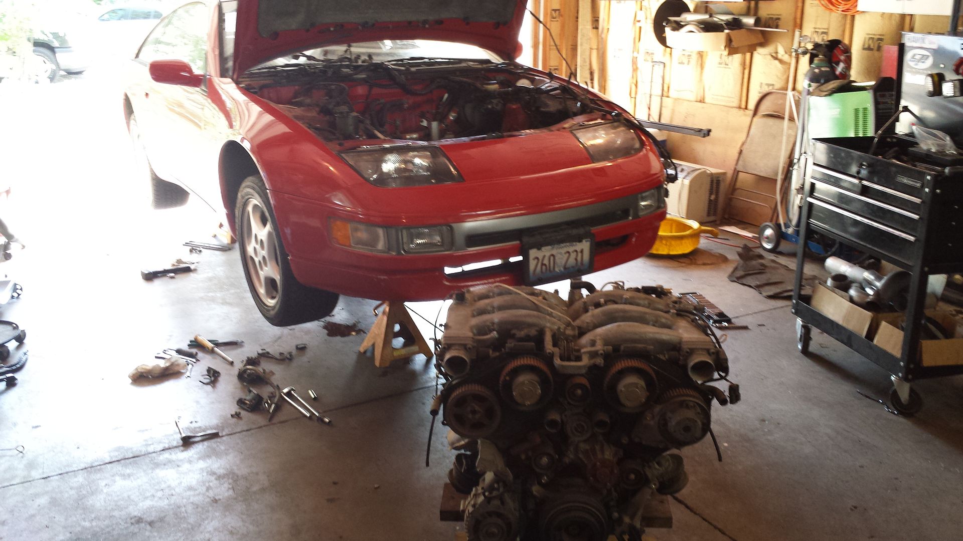

Message A few weeks ago I stumbled across a craigslist ad for what I considered to be a very cheap non-turbo. I spoke to the owner who was very uninformed of its condition so I just decided to take the trailer, some cash, and go look at it.

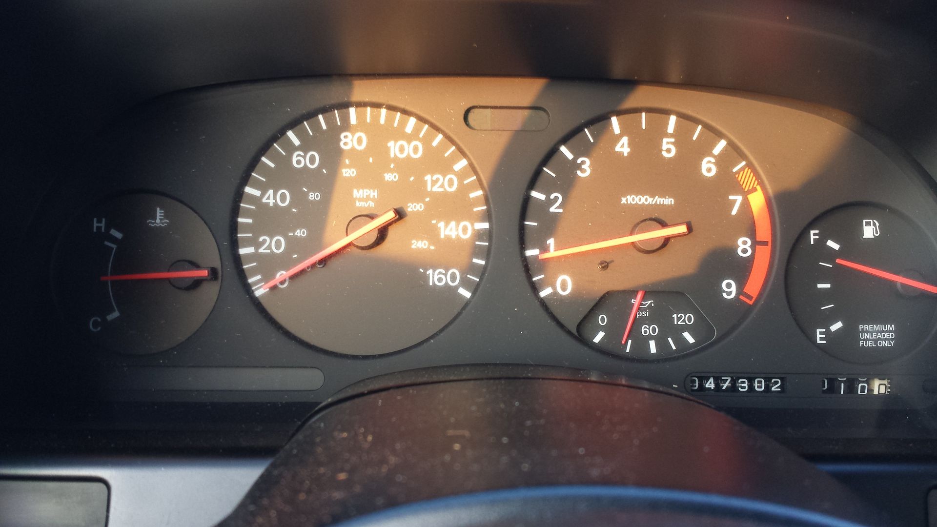

The symptoms were that the engine wouldn't turn, etc. It seemed in pretty good shape so I decided to take on the project. This is the lowest mileage Z car I've touched to date. It has 47k on the odometer and was a 1-owner car. It was an older lady who recently passed away and the car was just setting. The man I brought it from was her brother who had power of attorney.
Immediately I got to work

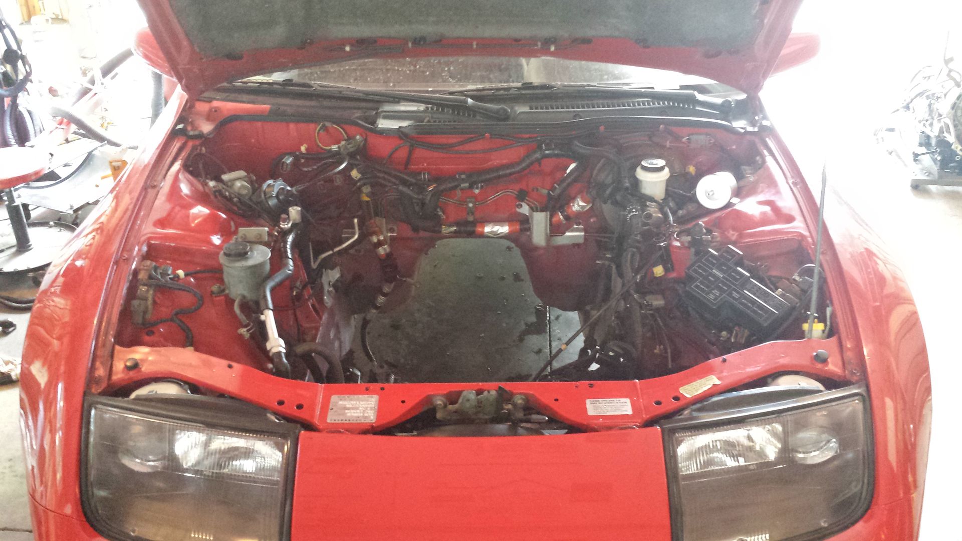

Cleaned up the engine bay while it was out

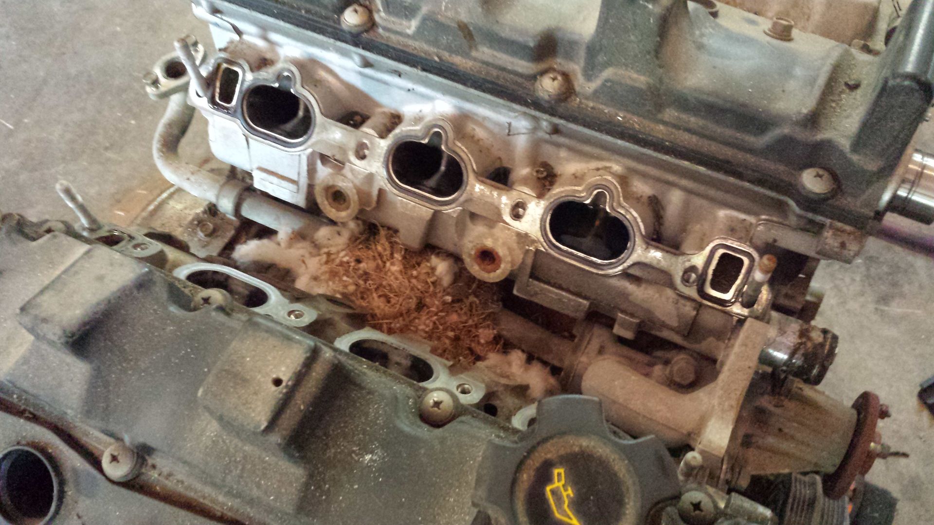

Found the usual. The rodent actually chewed off the entire knock sensor harness!

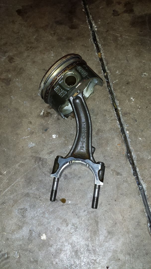

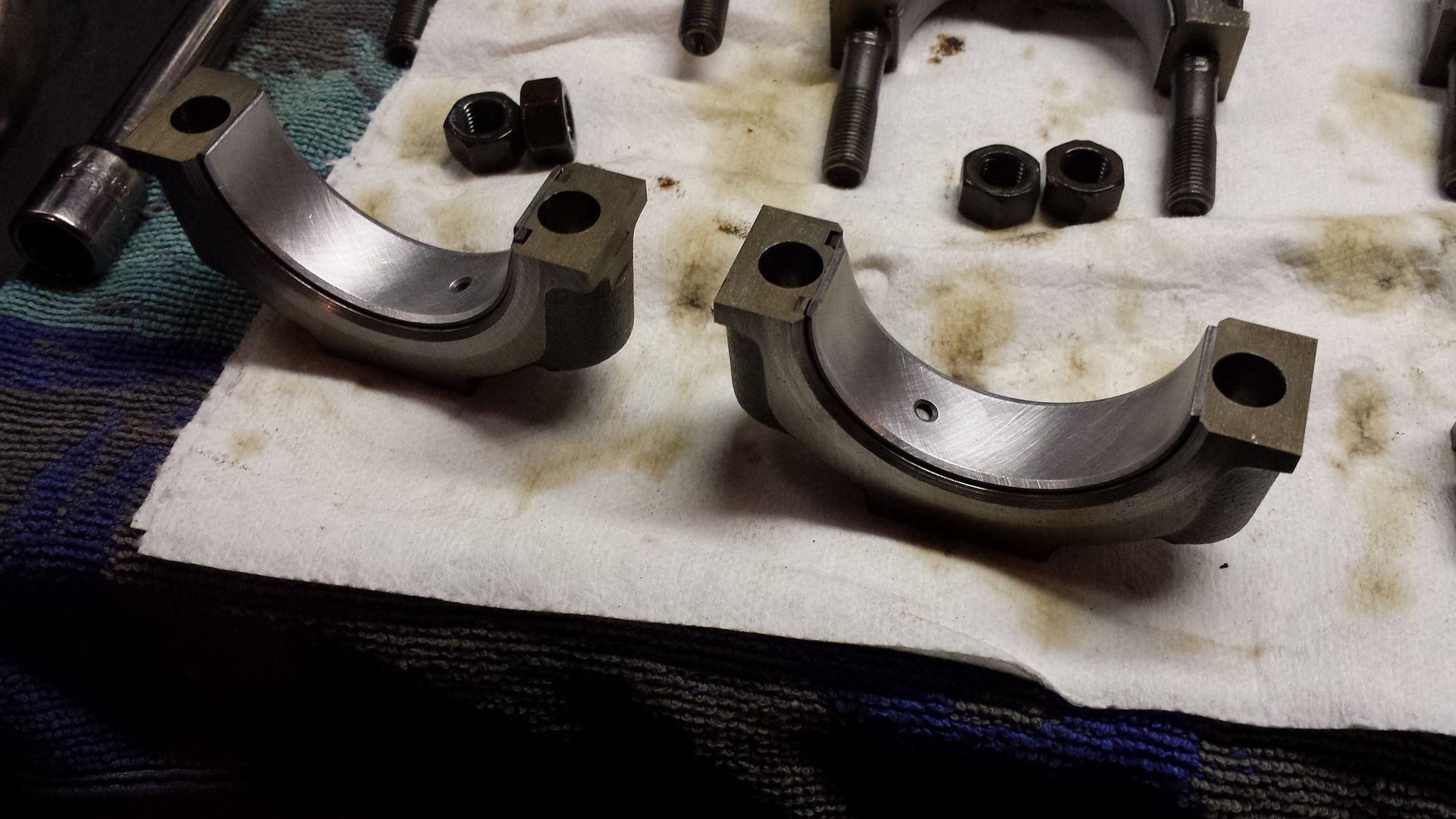

Then I found the real meat and potatos
The root cause was a botched injector job. When I pulled the fuel rail I found the #2 lower O-ring ripped. The hydrolock must have happened instantly because there was 0 collateral damage to anything else other than the rod

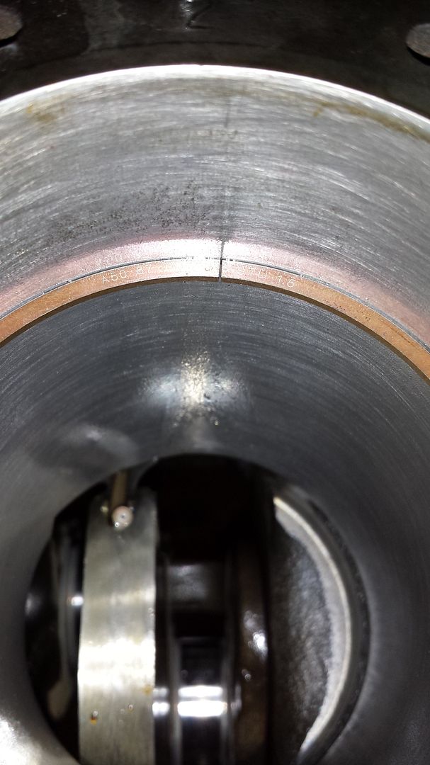

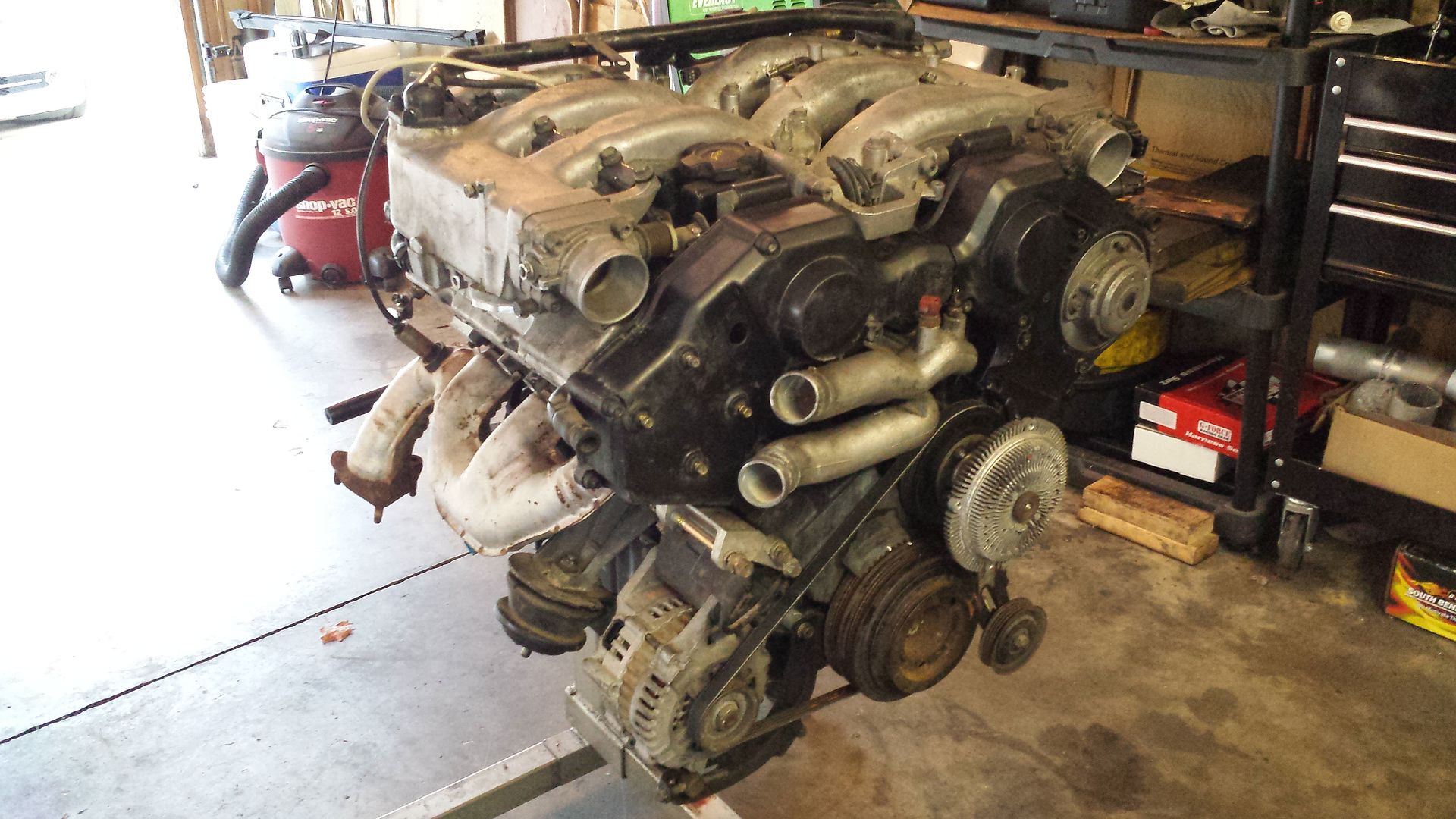

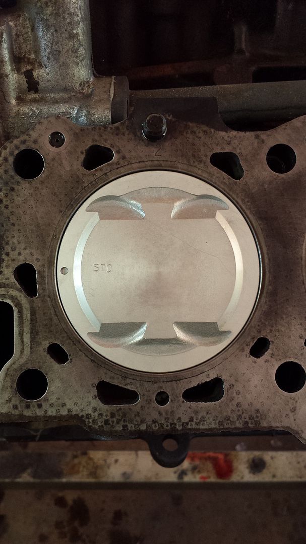

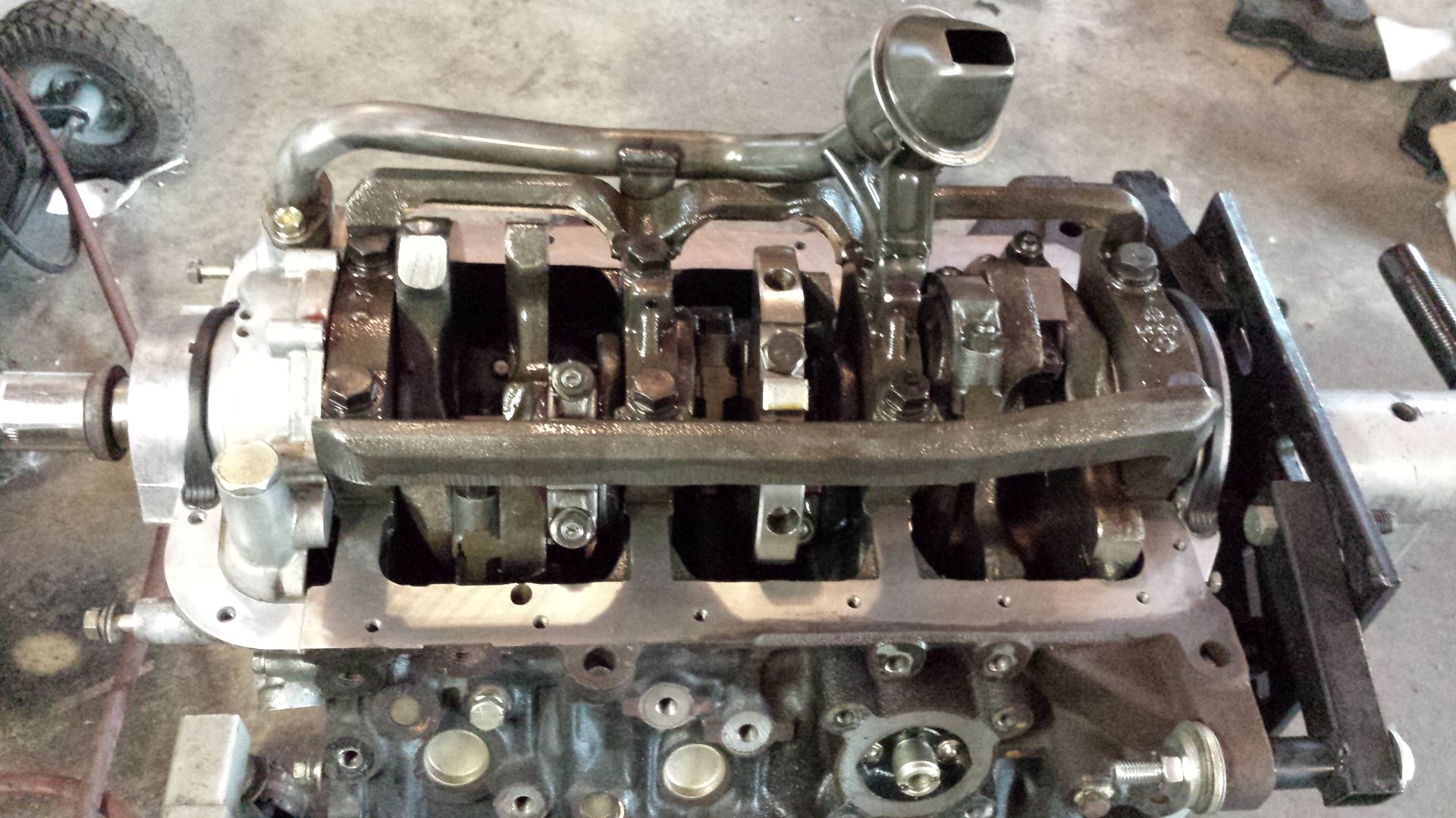

I decided to use this engine and freshen everything up. I replaced the piston and rod and installed all new rings along with the entire slew of OEM parts (120k kit, injectors, etc) I also got rid of the AIV's, EGR, Plenum coolant lines, etc.
The piston is non-OEM because I had a set of brand new STD NA pistons a customer had left behind.

I missed a few steps because I got pretty hot and heavy into my labor (worked solid from 10AM-3AM yesterday!)

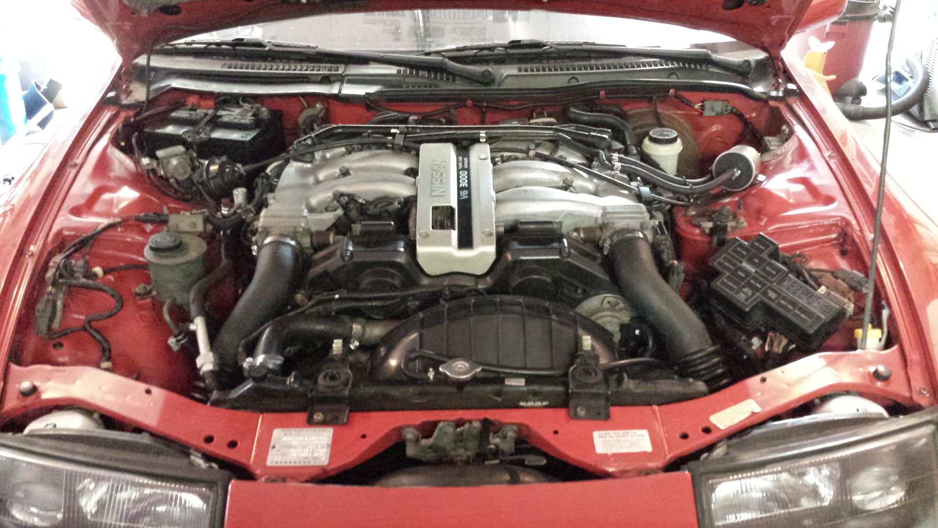

I got the engine and everything else installed today and went out to work on seating the rings. So far the car drives really well (as well as a stock non-turbo does)

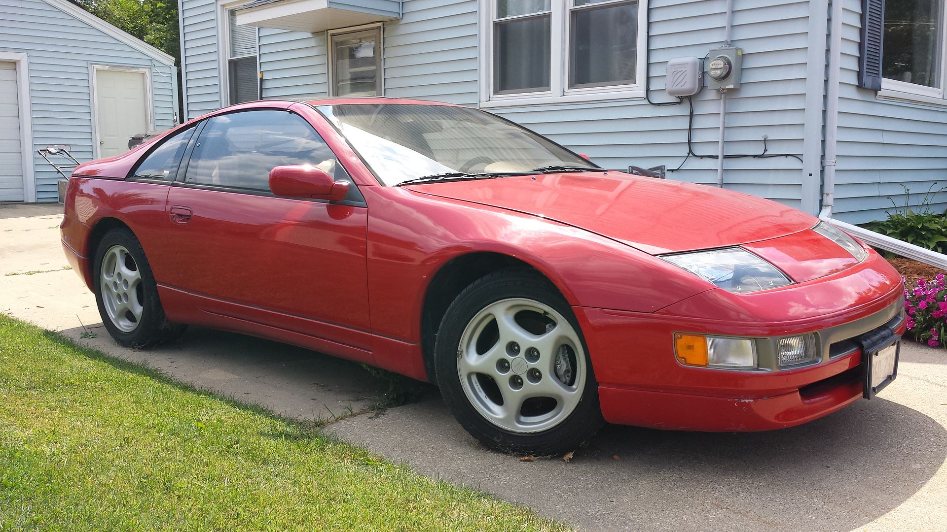

Before anyone sais it I know the wheels are on wrong. I gave the older guy an education session on how and why the wheels are setup the way they are, he seemed confused
